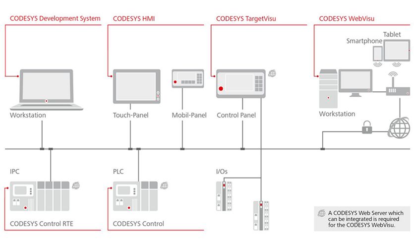

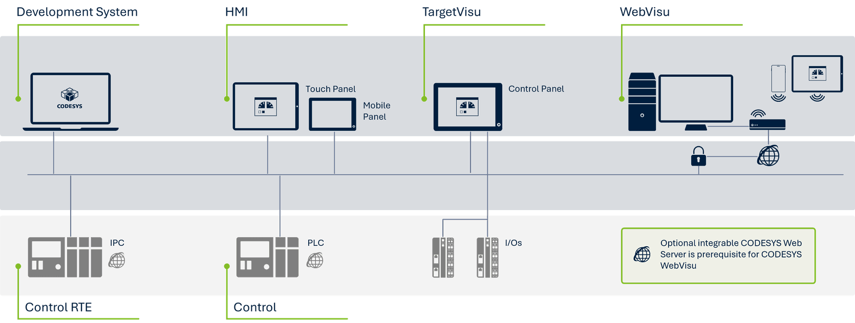

Available products and display variants
CODESYS Visualization is available as CODESYS WebVisu, CODESYS TargetVisu, and CODESYS HMI. The functional scope of these three variants is largely identical, but the technical functions differ.

If you integrate CODESYS into systems or use it in machine or plant construction, the following options are available to you with CODESYS Visualization:
  • A control system with CODESYS WebVisu.
    Which one? Take a look at CODESYS Inside.
  • A SoftPLC for standard platforms from the CODESYS Store. You license the CODESYS WebVisu via application-based licenses.
  • A controller with the CODESYS TargetVisu.
  • CODESYS HMI as a client for collecting data from any controller via OPC UA and for providing the CODESYS WebVisu
  • Download the CODESYS Development System (from CODESYS V3.5 SP10) free of charge from the CODESYS Store and install it. A demo version of CODESYS HMI SL is included with the setup and can be tested immediately. Alternatively, the current version of CODESYS HMI SL can be downloaded separately from the CODESYS Store.
  • Purchase licenses for a full version of CODESYS HMI SL in the CODESYS Store and store them on the target device - including optional licenses if required, e.g. to expand the scope of variables or to integrate CODESYS WebVisu for the parallel display of HMI visualizations on HTML5 browsers.
