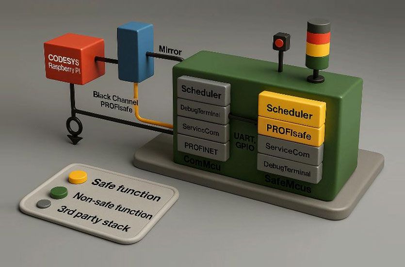

On the safety controller side, CODESYS® Virtual Safe Control is used to provide FSoE and PROFISAFE master functionality without specialized, certified hardware, while MESCO provides or develops the tailored Motion Control or I/O modules according to customer needs using proven safety design packages.
Virtual Safety Control by CODESYS®
The Virtual Safety Controller from CODESYS is a TÜV®-certified software solution that enables safety logic execution on standard industrial PCs and ARM devices such as the Raspberry Pi 5, without dedicated safety hardware expected to be released in September 2026.

Custom Safe Drive and Safe I/O Modules by MESCO Engineering:
Thomas Best continues, “MESCO Engineering, known for its expertise in custom hardware/software development, complements this software innovation with tailor-made safe I/O modules. These modules can be developed specifically for customer requirements and meet the highest safety standards by using the MESCO Safety Design Packages”.
The capabilities of MESCO Engineering Safety Design Packages include:
  • Design and development of safe motion monitoring electronics or safe I/O modules, integration of safe fieldbus interfaces such as FSoE, PROFISAFE and CIP Safety
  • Support for SIL2/SIL3 electronics
  • Full development support from concept to certification
